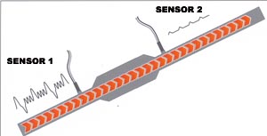

He estado mirando por ahí y podría hacer una prueba sencilla con el ODB para revisar si las sondas están funcionando bien. Lo que se tiene que mirar es que el voltaje de la sonda 1 fluctué rápidamente al acelerar y desacelerar y el voltaje de la sonda 2 se mantenga mas estable que la primera siempre por encima de los 250mv.

  • Look at Long Term Fuel Trims (LTFT). These show the amount (in %) the computer is modifying fuel delivery, based on the [SUB]02 [/SUB]sensor feedback. Positive numbers indicate the computer is adding fuel, negative numbers indicate the com*puter is removing fuel. Large positive numbers (>10%) should be investigated further as they indicate the computer is adding more fuel than originally designed.
  • Look at the O2 sensor output signals. Sensor 1 is before the converter, Sensor 2 is behind the converter, Bank 1 and 2 are typically used in V-configuration where Bank 1 is on the side Cylinder 1 is located. Some inline 6 cylinder engines have Bank 1 as Cylinders 1-3 and Bank 2 as Cylinders 4-6. The sensors are usually abbreviated as O2S1B1 (O2 Sensor, Bank 1)
  • Sensor 1 output should be very active and oscillate rapidly from approximately 0 to less than 1 volt. If the signal tends to show high voltage with little fluctuation, excessive unburnt fuel is reaching the sensor. If Sensor 1 shows low or no voltage, the sensor could be defective, or there might be an exhaust leak in front of or immediately behind the sensor, or there could be a lack of fuel delivered to the combustion chamber.
    If the sensor does not respond to a rapid accelerator kickdown, chances are the sensor is defective. If it does respond, an exhaust leak or lack of fuel is indicated. (The preceding test must be done after the engine and exhaust system have been allowed to fully heat up.)
  • Sensor 2 should show a fairly steady signal. It is not critical what the signal is, only that it does not oscillate as frequently as the front. If the signal is above 250mV, the sensor is fine. If it is below, check for activity by rapid accelerator kick-down or by raising the engine speed to approximately 2000 rpm. Any movement indicates the sensor is fine.

Bueno pues tal y como os comenté he revisado los valores de las dos sondas que trae mi coche en marcha con el OBD, es el motor de 5 cilindros (B5244S). La primera sonda arroja valores entre 0.4 a 0.5 a ralentí y llega hasta 0.8 cuando se acelera. La segunda sonda, me tiene mas escamado, ya que arroja valores en los rangos de 0v a 0.8. Cuando dejo de acelerar es capaz de bajar hasta los 0v. Ese no debería de ser el comportamiento normal, no debería de bajar a menos de 0.2. Si alguien puede realizar también la prueba en su coche podríamos comparar valores, aunque mucho me temo que lo de los 0v indica que la sonda no está del todo bien. También me parece raro que el comportamiento sea justo al contrario de que lo que se indica arriba. Es decir, la primera sonda no fluctúa mucho con los cambios de aceleración y la segunda sí. Otra cosa puede ser que el OBD me esté confundiendo con respecto al número de sonda y las muestre en orden inverso. No sé si se me entiende.
¿Que opináis?
